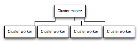

Run your app in a cluster
In a multi-core system, you can increase the performance of a Node app by many times by launching a cluster of processes. A cluster runs multiple instances of the app, ideally one instance on each CPU core, thereby distributing the load and tasks among the instances.
IMPORTANT: Since the app instances run as separate processes, they do not share the same memory space. That is, objects are local to each instance of the app. Therefore, you cannot maintain state in the application code. However, you can use an in-memory datastore like Redis to store session-related data and state. This caveat applies to essentially all forms of horizontal scaling, whether clustering with multiple processes or multiple physical servers.
In clustered apps, worker processes can crash individually without affecting the rest of the processes. Apart from performance advantages, failure isolation is another reason to run a cluster of app processes. Whenever a worker process crashes, always make sure to log the event and spawn a new process using cluster.fork().
Using Nodeâs cluster module
Clustering is made possible with Nodeâs cluster module. This enables a master process to spawn worker processes and distribute incoming connections among the workers.
